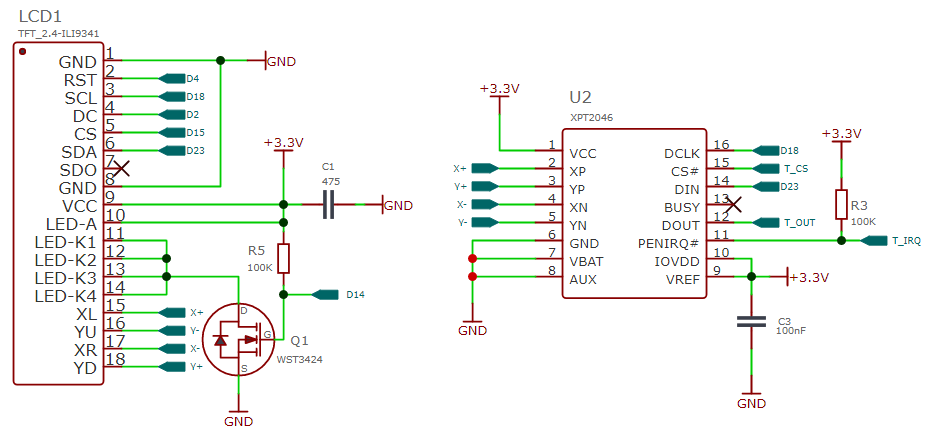

hi,Bernard Binns,my touch screen is reversed , what should i do? 73!

RX1900, what do the following lines look like in your sketch?..
#define SCREEN_V 0
#define SCREEN_H 1
uint16_t calDataV[5] = { 258, 3566, 413, 3512, 4 };
uint16_t calDataH[5] = { 387, 3530, 246, 3555, 7 };
#define SCREEN_V 0
#define SCREEN_H 1

hi, binns ,i didn't make any changes .Up,down,left and right are opposite Horizontal mirror !

I've tried and nothing has changed

Ok, change in sketch lines:
uint16_t calDataV[5] = { 258, 3566, 413, 3512, 6 };
uint16_t calDataH[5] = { 387, 3530, 246, 3555, 5 };
